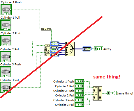

There is really no need for all that dynamic data. Compare the two code sections in the attached image. Their output is identical, but the lower part is arguably slightly simpler. 😄
