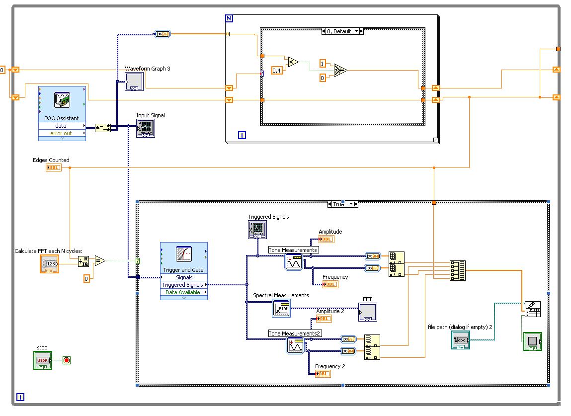

I want to execute a case structure inside a while loop only once. The case strucutre is controlled by a counter, so that every time the counter has a value multiple of N, the program records an acoustic signal and calculate the main peaks of the FFT. The problem I have at the moment is that, every time the case is executed, it records and analyze the sound several times until the counter jumps to the next value. I want the case to execute only once every time the counter has a value multiple of N. I atttach the vi.

Hi Franky,
right now the case structure is called with
IF counter = zero
You should change that to
IF (counter = zero AND counter <> previous counter value)
Btw.  there are special functions to compare for "=0". There is also a function to convert a boolean to 0/1.
Message 2 of 13
(7,839 Views)
GERD is right.  You should use a feedback node to store the previous count value.  If the current count is Not Equal AND the remainder is Equal To Zero run your case.
Since your counts are all integers, I would also recommend changing the representation to an integer type.  I32 would likely be the most appropriate.

Already solved! Thank you guys!!
