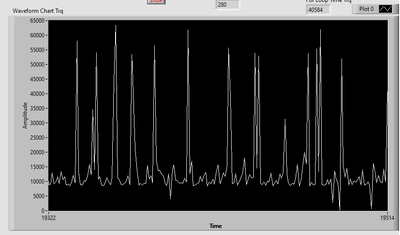

I am sending model data from real time target to R series FPGA over DMA FIFO using Array. FPGA vi have for loop inside while loop to get back values from array. But I am seeing while loop speed fluctuations between 10 K to 65 K ticks as shown below. I am not sure if this is because of for loop or DMA FIFO. Any help on it is much appreciated.
Amplitude in TickAmplitude in Tick

Can you post pictures of your FPGA code?
Variable tick count could mean you are using a regular loop and not a single cycled timed loop (SCTL).

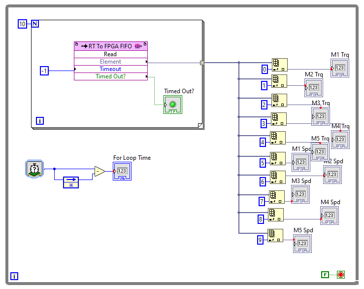

Sorry, I have added FPGA VI in my original post but for some reason I don't see it . Here is the screen shot.For loop inside while loopFor loop inside while loop

As Terry said, that is a regular while loop and not a single cycle timed loop.  You should use loops with blue borders in the FPGA.
Also, you have an unnecessary number of Index Arrays.  And you don't need those constants.
Delete all but the top one, drag the bottom border downward and you'll have more outputs.  By default they will be index 0, 1, 2, ..... without having to wire up any index constants.

I made changes as you suggested and replaced while loop with single cycled timed loop. During compilation I got following error.
Error -61003 occurred at
Possible reason(s):
LabVIEW FPGA: You cannot include this function in a For Loop when the For Loop is inside a single-cycle Timed Loop.

You're also reading from a buffer with infinite timeout, so it could be your FPGA code is totally fine but the buffer is being filled at a variable rate.

Move the indicator out of the for loop.
