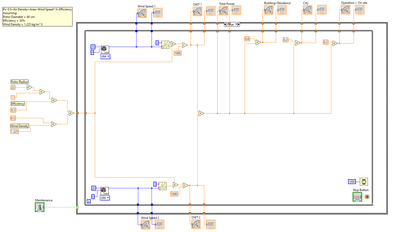

Just started to learn LABVIEW and face this kind of difficulties. The while loop is not working, but when the stop button is pressed the loop is happen only for a cycle. Looking for help/suggestion.

Move all indicators inside the loop. Think in dataflow. The data in the wires outside the loop only updates once the loop has finished.

  • Hi Dewey,
The while loop iterates once per second
  • when the Maintainance button is FALSE initially
  • as long as the Stop button is FALSE
You can even see the iteration once you start debugging using the highlight execution tool: you really should use this to help you understand your own code! 🙂
(2,271 Views)
Accepted by topic author MDewey
I'd say the code works as expected, not just as you wanted it to. 🙂
As a tips you can r-click the needle meters and activate Visible Items -> Digital display so you don't need to update 2 controls for each value.
LV will read the Stop button long before it starts the wait, so it'll loop around one extra time and have on average a 1.5 sec stop time.

Hi, thank you for your reply. Yes, since the numeric indicator did not showing any number, i thought the problem is on the loop. Thank you for letting me know.
