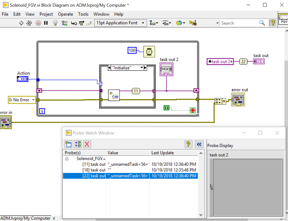

I'm running the FGV on it's own so input errors shouldn't come into effect here, but I went ahead and isolated it anyway. I added a probe so you can see that the initialize case should be the one firing, and yet probes 6 and 7 still have different data.
I'm relatively new to LabVIEW, but I don't see where a race condition could come into this, especially when it's not being using as part of a larger VI.

I call it 3 times in my code, once to initialize, once to retrieve the task wire, and once to exit. There shouldn't be any way for those to overlap due to managing flow with error wires, but I've attached both my main program and the initialization code here anyway.
However, the main program doesn't even come into the specific problem seen with the probes, as I'm running the FGV as its own VI to get that information, not calling it from outside.
Message 27 of 33
(1,635 Views)
Exactly. No need for all that extra code. As I already said, something is wrong here.
  • Maybe something in your VI is corrupt (try to force a recompile)?
  • Maybe the compiler makes a mistake (try to place an always copy somewhere near probe 6)
  • Maybe your installation of LabVIEW is corrupt? (Repair or reinstall, incl. DAQmx, but try the above first)

Maybe something in your VI is corrupt (try to force a recompile)? Maybe the compiler makes a mistake (try to place an always copy somewhere near probe 6) Maybe your installation of LabVIEW is corrupt? (Repair or reinstall, incl. DAQmx, but try the above first)
I tried the first two suggestions and no dice. If I have to, I'll reinstall, but I'd rather not come to that.

I tried adding some DAQmx functions and that didn't work either, unfortunately I did find one way to get the reference out, which is to attach a local variable to an indicator inside the while loop, as seen below, so that no wire crossed out of the loop. Unfortunately, I can't seem to make this strategy work to pass along the reference for the Get and Exit cases.
