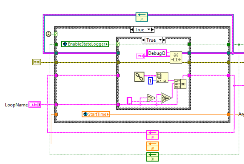

I use named queues in my loops for debugging purposes. You can use them without worry if used carefully and in parallel situations.
  1. Use First Call and a FGV like construct.
  2. If used in loop/VI that closes before the Main VI is finished, then use the Release Queue function to close the reference to avoid a memory leak. If the loop runs until the Main VI closes you can Force destroy all named instances that are open.
