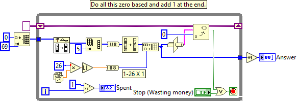

Here's a quick version I just made. seems similar, but using the riffle index for simplicity. I am sure that improvements are possible.
Today I learned how to Riffle. I think the only other thing is to move spent out of the While Loop so it doesn't refresh the UI every iteration.
By default, indicators are not set to "advanced...synchronous display" so the fast loop just updates the transfer buffer of the indicator, while the indicator update (transfer buffer to indicator) occurs asynchronously in the UI thread at a much slower rate. It will probably not slow you down, especially if you have multiple cores. I doubt it will be noticeable unless the rest of the loop code is extremely cheap (not here).

Since you seem to be in a learning mood, here's something completely different :D.
This version uses variant attributes(!) for the database. Since attributes are stored in a red-black tree, searching for a match is much faster (O(logN), vs O(N)). It is easily twice the speed of the previous versions.
See if you can figure out how it works. A great addition to any programmers skill set.  😄
Message 13 of 24
(5,529 Views)

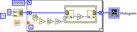

While I agree on the other points. I think I still need to multiple by 69 to get uniform distribution. See more unoptimized code below 🙂
Agreed. Here's a slightly more optimized code to generate the same histogram: (one loop instead of four :D)
