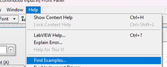

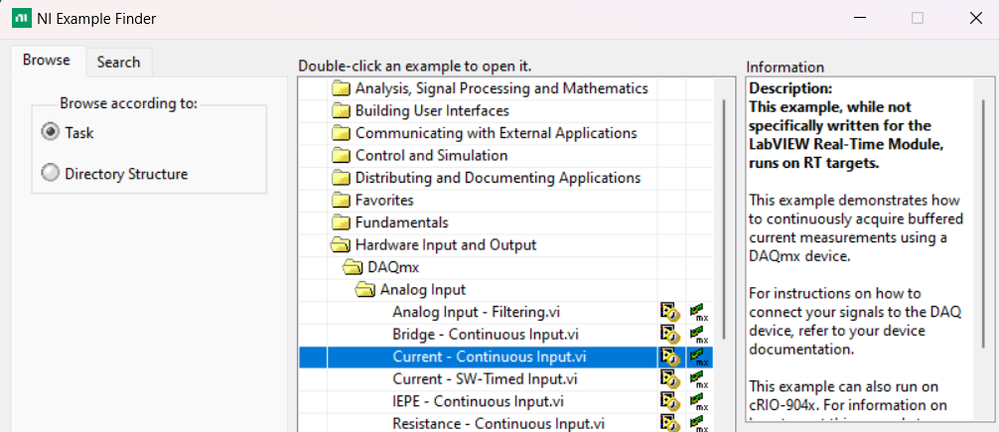

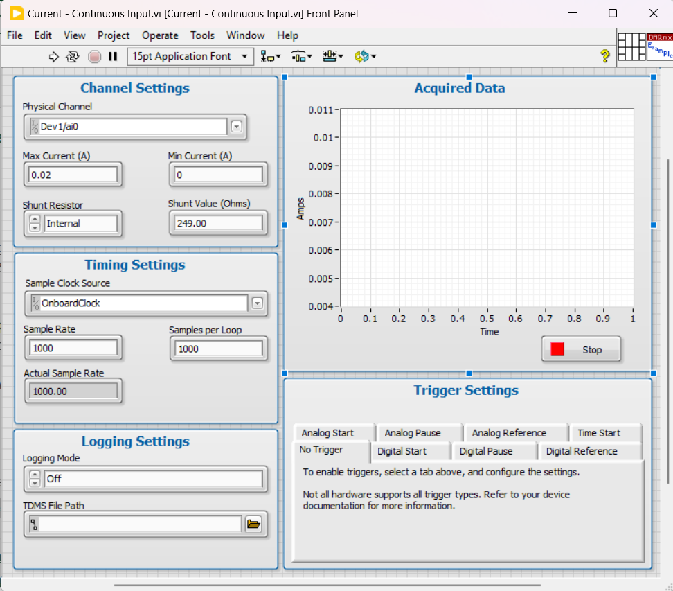

Please start with the Current - Continuous Input example, it will showcase how to use the DAQmx APIs to collect continuous data along with TDMS logging.
Santhosh
Soliton Technologies
