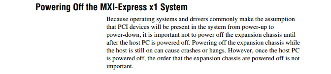

Have you read the manual for that device?  Smiley Tongue
From chapter 3 of the MXI-Express x-1 Series User Manual...
Stated otherwise ...
Message 4 of 14
(5,588 Views)
