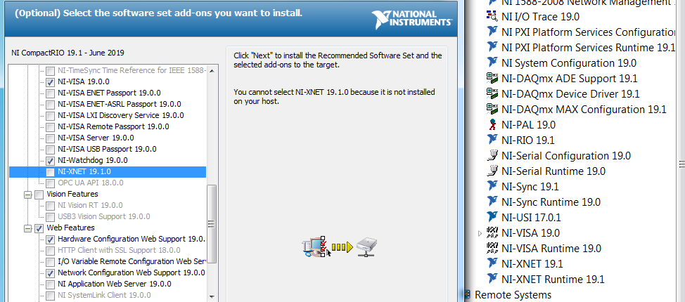

I have a cRIO-9067 and a NI-9860 XNET module. I am trying to install NI-XNET onto the cRIO, but I am unable to. When I use MAX and use the Add/Remove Software Wizard, the option to check NI-XNET 19.1.0 is unavailable, stating that "it is not installed on your host", despite MAX reporting it installed on my PC. I have NI CompactRIO 19.1 installed as well. I am using LabView 2018 on Windows 7 Pro.
Before I used CompactRIO 19.1 I had 18.5 installed, so I installed XNET 18.5 and the same error occurred. I also fully removed the entire LabView stack from my PC and reinstalled it and no dice.
Is there a step I am missing here?

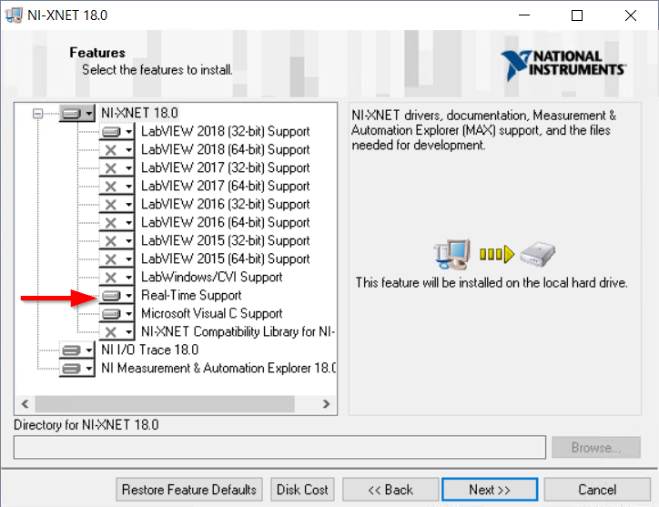

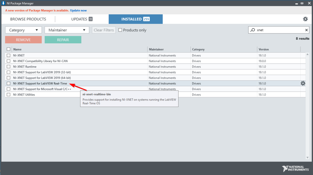

Donney, do you have installed the XNET Real-Time support?

Donney, you should be able to select the option when installing the driver:
NI-XNET 18 and previousNI-XNET 18 and previous
NI-XNET 19 and newerNI-XNET 19 and newer
If you do not see the option, make sure the Real-Time module is installed.
