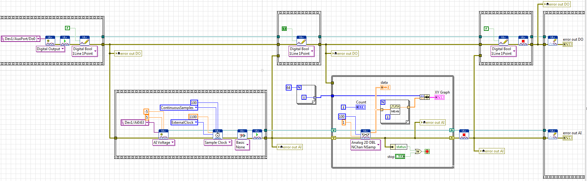

In short, we have an AI task with an external clock. However, the ULx Read VI reports that there is no external clock. To exclude hardware issues I would like to view the external clock in for example InstaCal.
Are there any other comments or suggestions about the VI shown below?

We use a laser trigger (approx 1000 Hz) as the sample clock. The intention is to use two ADC cards, but in the example shown we use only one. (the inline figure is also attached)
From left to right:
  1. we set up a DO task and set DO0 to false to block the laser trigger (using an AND gate).
  2. we set up an AI task with an external clock. We start the task(s), but because the trigger is blocked, no data is converted.
  3. DO0 is set to true, unblocking the laser trigger
  4. we read out data in a while loop
  5. we stop the AI task
  6. we block the trigger and stop the DO task
  7. we clear the tasks

Hi, Robbert (unusual spelling, that).  An interesting problem.  It would really help to attach the actual VI, rather than a picture (very tiny on my monitor, hard to read) of only a part of the VI.  There may be things either "off the page", "in another case", or "hidden in the details" that would help us help you figure this out.
Bob (yes, with two "b"s, also) Schor
(4,067 Views)
Hi Bob,
I attached a bigger version of the screenshot to the original post. I can attach the VI as well (tomorrow), but the VI is stripped down to the bare essentials and there is not much more to it than what I show.
Best,
Robbert
(4,049 Views)
Here is the actual VI.
(4,024 Views)
