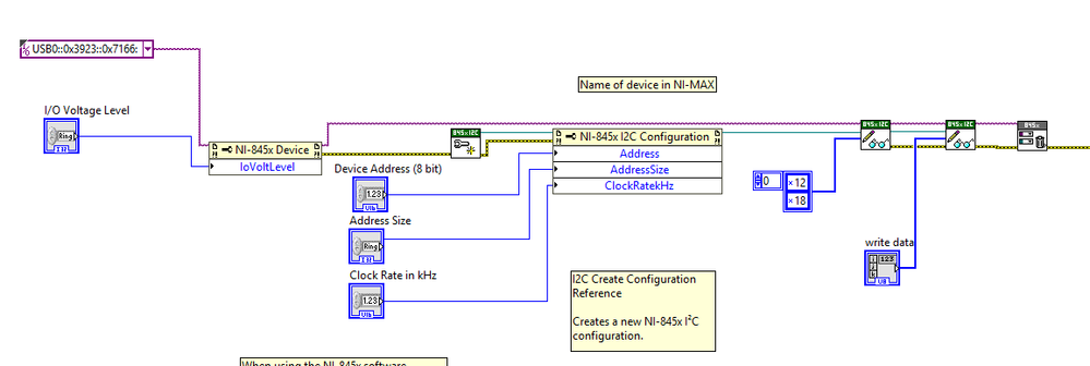

So at work the goal is to send I2C commands to a Port Expander (PN:MCP23017) but I am completely lost also semi-new to LabView anyways. I understand at a high level what needs to happen in order to write to the Port Expander. Datasheet says I need to first write to it and "Define I/O Direction" then after this is defined I can write to send the actual data.
I downloaded the NI-845x drivers and I have all the I2C vi's available. I'm just so lost on how to actually code this and write anything. I feel like I'm missing an extra write step for defining the I/O direction but I don't know. I keep getting the Error -301742 which says "The slave did not acknowledge an address+direction byte transmitted by the I2C master."
The following is my attempt so far....
It looks like you are on the right track.  As you said, you need to set the port to be an output (defaults to input).  Here's what I put together really quick.
NOTE: I barely skimmed the data sheet and have not used this chip.  So no promises it works.
Something you might want to consider is making a VI to write to a Register.  It can put the register and value into an array and write the I2C message.  I have something similar hiding in my libraries.

Oh so you think I might have to use 2 write blocks: 1 for defining I/O direction and the other for data.
How come you used different control types for each write?
For the first one, I hardcoded the direction to be output.  For the second one, I was writing a desired value.  So basically it was two different situations, so the way I built up the array was different.

I just keep getting an error, I feel like I'm so close. Thanks for the help though, I know its hard to troubleshoot this with me when you cant physically see my setup.
The error claims in invalid setting.  What values values are you using for the device address, address size, and clock rate?

Maybe it's easier if you just open up my code? If not let me know.

Clock Rate is default to 0.  That is likely your problem.
