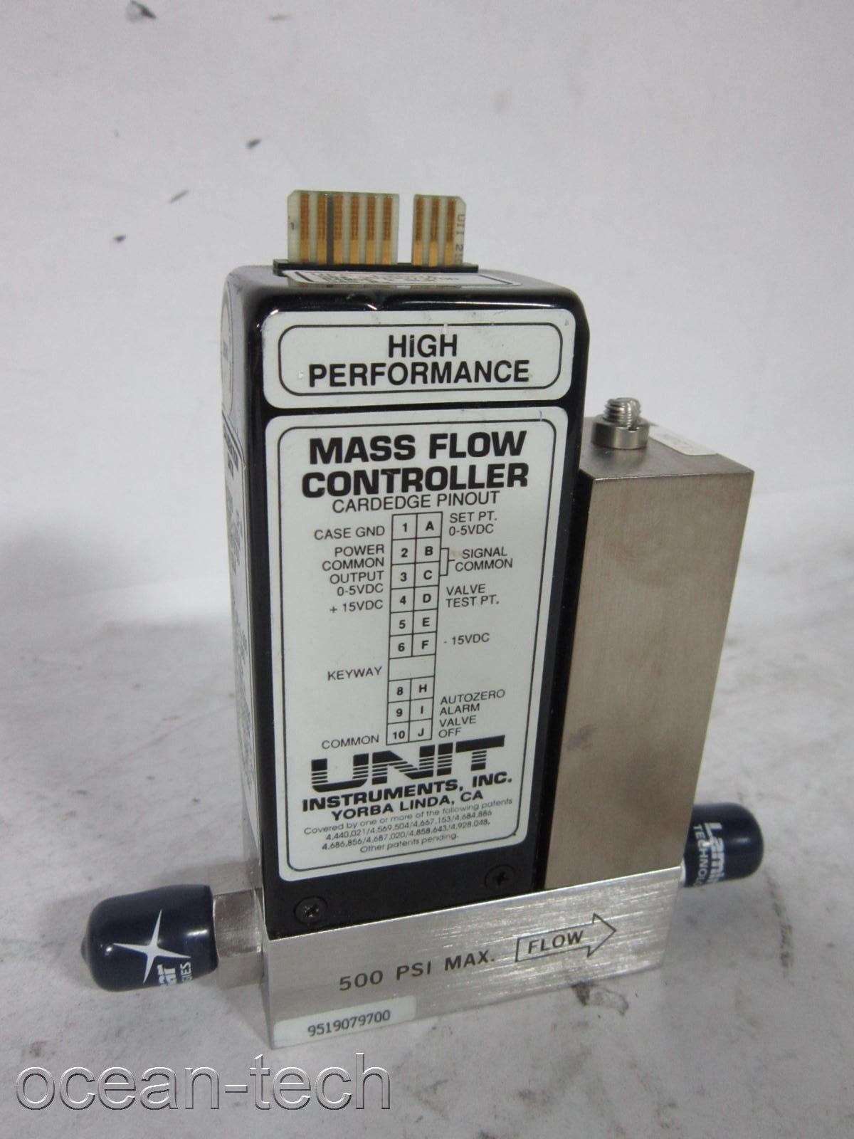

Hello everyone
I have bought a used "Unit UFC-1200A MFC" Mass Flow Controller, N2 gas, 2 SLM.
I have searched the whole net but I could not find any datasheet for this mass flow controller.
I am really confused!
Please help me.
Thank you

You do not need data sheet, you have the pinout in your photo. It gives all necessary info...

Thank you for your answer.
So could you please tell me:
What is CASE GND, POWER COMMON, COMMON, SIGNAL COMMON pins? How should I connect them?
How much current will consume the MFC when I connect it to 15 volt power supply? (this will help me to select a proper power supply).
What is VALVE TEST PT?
Is the 0-5 VDC Iinput/output  linear with 0 to 2 SLM?
Thank you
Message 6 of 8
(4,519 Views)
You need to power the mfc using a power supply capable to create a +-15VDC outputs (PSU should have 3 outputs). I think the mfc pulls max a few hundreds of mAmps current, so check the PSU if it can do so. Connect the PSU to the mfc with 3 cables as it makes sense (power common to the GND or "0" output of the PSU, the +15 to the +15VDC, the -15 output to the -15VDC of the mfc).
Signals:
Connect the signal inputs/outputs to your AIO device as described on the pinout picture...
