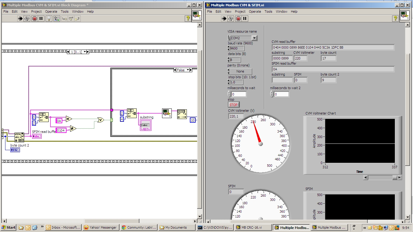

i wanna ask how to multiple request and response on MODBUS RTU using VISA ? i tried to monitoring 2 device digital metering, i made a Labview program to communicate that device alternately using Stacked Sequence Structure, but it only can communicate with 1 device, and the response i think there are some error, the number of byte doesnt match what i request ( 0A04 0000 0002 70B0 )

i did it if just one device and can work correctly,  this is my screenshot on 1 device
i wanna try using VISA firstly ( basic serial communication ), next i`ll try modbus library
any suggestion ? am i right using Stacked Sequence Structure ?

It was pretty tough to see that video.
Obviously in the 2nd frame, the lower comparison was coming out True which meant the False case where stuff happened couldn't execute.  (Seems like reverse logic to me.)
Well you check the first two bytes to see if they were not equal to 010A.  Well they were because that is the response to the command you send taht started out 010A.
In the first frame it worked because you send out the command starting 0A04, and compare to see it is not equal to 0404, which of course it is not.  What is the point of this?  It seems like mixed up logic.  That you want to confirm it is the correct slave address and correct command (thus they would be equal) in order to execute the decoding code.
The other comparison is pointless also because you are trying to see if the first two bytes are equal to 0A, (no matter which frame you are in) which they will never be because a 2 byte string can never equal a 1-byte string.
By using highlight execution, you should have been able to figure out what was and wasn't executing and why.

Hi Raven,
i need that to compare, because this digital metering if on Serial Communication using VISA cannot work perfect, see this video, this video when i didnt use comparison.
https://www.dropbox.com/s/st6qs1cbtr72m0m/bandicam%202014-05-05%2015-06-09-546.avi
so on that video i need to compare to distinguish when the data will be processed.
this video when i did with comparsion, work correctly without miss data
https://www.dropbox.com/s/illmc235nn8kv3z/bandicam%202014-05-21%2016-12-36-500.avi
yeah i just realized, compare 0A is useless Smiley Very Happy
