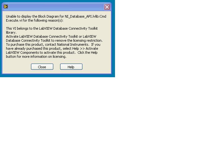

Yes, I got unable to display the block diagram, and ask me to activite the toolkit. I have a licenced labview, and evaluation of Database toolkit.
the error is attached.

In this case it looks like this VI has been locked for the evaluation version, looks like you will need to upgrade to the licensed version to implement this fix.
