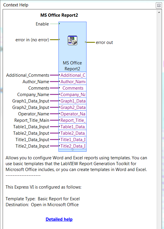

I am using the following VI to create the report.
Message 3 of 10
(6,238 Views)

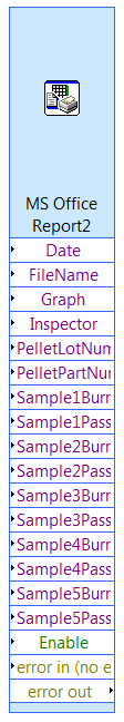

Hmmm, interesting. Not sure what I am doing wrong. Do I need to do something on my template possibly?vi.png

Accepted by topic author CastleWorks
Do you have the report destination set to "Save to File"?  If it's set to Open in Office, the save path input goes away.
aputman
Message 8 of 10
(6,205 Views)
FOR THE WIN!.....yep that was my oversight.  Thanks for the help!
