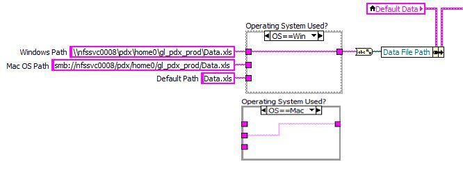

It turns out that for the Mac OS, the acceptable path element "slash" separators lean a different direction from those used in Windows. No doubt some organization wanted to set themselves apart with the difference. That difference meant that a Windows path constant, control or indicator will not accept a Mac OS path without first mangling it into something that won't later work on the Mac OS.  The solution was to use text strings to contain the paths that are appropriate for each system with the proper string selected by a conditional selector that is sensitive to the OS in use.  The string-to-path conversion function turns the selected string into a usable path for the given OS.

After some testing on a Mac we discovered that the string-to-path function strips out the double forward slash delimiters that are used as part of the "smb://" that identifies the device as a network drive and replaces them with a single slash so that it looks to the LabVIEW open-file function like we are trying to open a local device/folder/file that does not exist.
