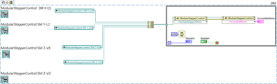

So my code has multiple very similar loops which must run in sequence as given in the snippet. The only difference between them is the reference each of therm get. First loops get a reference to move the Y axis motor while second loop gets the reference to move the Z axis.Now since each of these references are just local variables is there a way I can put them in an array and do only one loop instead of multiple such while loops.( I want to add loops for the other axes motors a swell, like X , Yaw, Pitch etc.,)

 Hope this is much better

I have given a much clearer snippet now as a reply to RavensFan, do have a look.
Edit: So a build array work fine. I attached the array to an auto indexed while loop, something like this

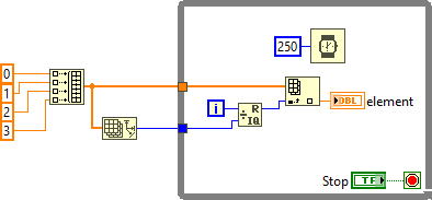

 Just one issue, I would want the array to wraparound itsef. i.e: after 4th iteration go back to the first array element to continue running the while loop until the stop condition is met. How should I do this??
To go with the quickest point first, use a While loop (because you want to continue indefinitely, from the point of view of number of iterations) and then use Quotient and Remainder with the divisor equal to the Array Size, and Index Array with the remainder as the index.
Something like this:
Here of course is just an example, I used Doubles but you'd want to use your reference array.
