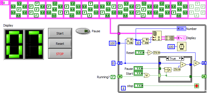

You already got some good advice. All you need is a simple state machine, no local variables and no sequence structures. One loop. One case structure, a shift register to hold the numeric (00..99) value (so it becomes independent of [i]) and some logic to transition between states based on the user input.
  • Start in an idle state
  • make sure that the number cannot exceed 99
  • Simplify! Simplify!
  • Work out all the logic using a simple numeric indicator, then create a simple subVI that converts the numeric to your 14 booleans (use an array of booleans!).
  • You have four identical case structures, each with 9 cases and 63 local variables (for a total of 252!!) . Sounds silly, right?
Message 4 of 9
(2,813 Views)
To give you some ideas, here's a quick modification based on some earlier discussion. See if you understand it. (I run it 10x faster so we can more easily play).
(Of course we need much more accurate requirements to finalize the code. For example should reset also stop the timer or just start over at zero?)

How did you make that array constant with all the true and falses? I'm attempting to recreate it and I am not sure how to create all those elements.
Message 6 of 9
(2,793 Views)
Hover over it and look at the context help to see the structure (array of cluster containing 7 booleans).
Message 7 of 9
(2,789 Views)
I see that but when I connect a Boolean, it only allows me to put one Boolean. Not seven like you have.
And for the front panel, not sure how you inserted the corresponding Booleans to the display because when I open the help menu, it states 7SEG. Not sure how you got that option.
Message 8 of 9
(2,783 Views)
The 7seg display details are irrelevant for the button logic. Do you know what a cluster is? An array of clusters?
Message 9 of 9
