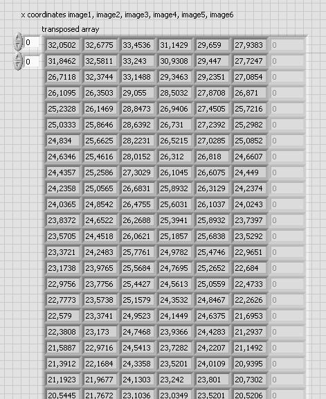

That's the result I want, but I can't do it that way. Here is why
Because of the indexing my results of the next 1D array show up on the right of the last 1D array as you can see in the next picture.
I can't use the build array.vi for my 1D arrays because I don't know how many  images (number of 1D arrays) will be processed. If I only could apply your solution to the indexing function my problem would be solved.

I don't know how your picture at the top compares with what you've shown up to this point.
You can combine multiple 1-D arrays without knowing how many there are.  You put the build Array in a For Loop.  Maintain the growing 2-D array in a shift register, and add each new 1-D array to it with the build array inside the For Loop.
