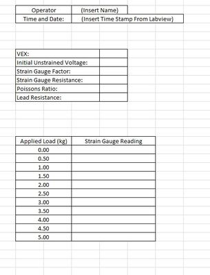

The program I have built is designed to measure strain when a load is applied to a steel tube. The load upon the steel tube will be increased in 500g weights which should hopefully lead to the program measureing a new strain reading.
I want the program to plot the strain values against the load values in an excel spreadsheet (In a Similar Style to the example below), however Im having trouble trying to make this work. Can anyone give me any clues or help on how I could make the program carry this out?
Cheers
Mike.

You can't write to Excel like you would a standard CSV or TSV text file.  It's a proprietary format from MicroSoft.  You'll need to either buy the NI Report Generation Toolkit or use ActiveX calls to create a table in Excel.  It's generally much easier to dump the data to a text file, then open that file with Excel and make your own tables and graphs within Excel.

About a month ago, I posted a "Revised Generate Excel Report Example" to this forum.  It uses (and requires) the Ofice Report Generator Toolkit, but does just what you describe.  A search of the Forum should find it.

The latest version of LabVIEW and Write to Measurement File supports native Excel.

Cheers for the help, found it and will adapt to suit my labview program.
