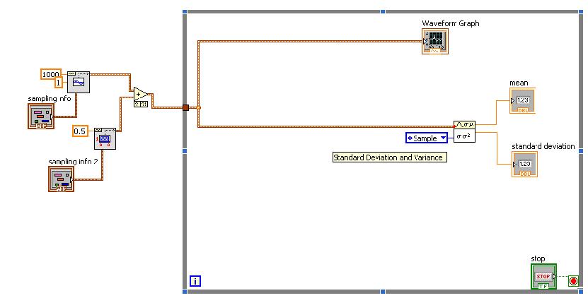

check this , i make a sinewave outside the while loop and add some noise in it. the sampling rate for both sine and noise is 3000 Hz sampling freq and 10000 samples. i then give it to a display and also to a std dev and varinace calc. i put the while loop only to keep the vi running otherwise there is no need as when it tum single time the calc will already be made.anlg std dev.JPG

Please stop posting VIs with greedy loops. You've been told this before and also about providing examplesb that teach bad practices.

you have told me before for the flat structure usage and i understand that thing please check your post. furthermore i have already mentioned in my post that this loop is nothing to concern with the vi, so there is nothing like motivating some one to use while loops. please read it carefully.

I did read it carefully. Since there is absolutely no reason for the loop, there was no reason to have it. Since you did have it, there was no reason not to use it properly.
Check your other posts where I responded for where I already mentioned your use of s while loop with no wait - a greedy loop and very bad practice.
