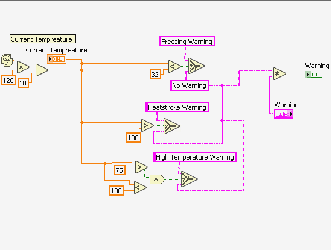

Hello, i am trying to figure out how to make my string output to the front panel. I believe that i wired it correctly, but it still refuses to output anything. Basicly i have to have it output freezing if it is below 32; no warning if it is between 32 and 75(inclusive); high temperature if it is between 75 and 100; and heatstroke if it is over 100. I have uploaded what i have done below. I am not sure what i am doing wrong. Also there should be a boolean led light, that switch on if there is any of the warnings except no warning. Thanks in advance!!!Screen Shot 2017-04-10 at 20.20.46.png

First, run block diagram cleanup to clean up your wiring.  Some of it is running backwards and makes it hard to debug the picture of your code.  Typically it is very hard to debug pictures and would be much better if you posted the actual VI.
Second, it might be because of the unclear wiring, but it sure looks like you have nothing coming out of the outputs of all those Select Functions.
Third,  Check your spelling.  The word is "Temperature".
Forth, the lower bit of code with greater than, less than, and AND could be replaced by an In Range and Coerce Function.

  • There are two things called "Warning" on your Front Panel and Block Diagram.  One is a String Control (meaning you read from it, you don't write to it), the other is a Boolean.  While it is "legal" to name two variables the same thing, it is foolish to do so.
  • I assume you want the String "Warning" to display "High Temperature Warning", or "Heatstroke Warning", or some other String.  Do you know the difference between a Control and an Indicator?  Do you know how to turn one into the other?
  • What do you know about the Select Function?  Right-click it, choose Help, and read the Help description.
It appears you know very little about LabVIEW.  Before working on this VI of yours, spend an hour or so with the beginning LabVIEW Tutorial material shown as links on the first page of this Forum.

Sure enough the outputs of all those select functions aren't wired to anything.  Why make a decision if you don't use the result?
In Range and Coerce.  Open Context Help and read the function.  There is an output that tells you if it is in range.
Your warning control should be an indicator.
Normally, I'd tell you in more detail what needs to be done and have you do the work yourself.  Instead, I'm going to show you the picture of what the code should look like.

Instead of all these successive comparisons, it would be simpler to threshold into an array of temperatures and then index into an array of strings. The boolean could be obtained from the index value (e.g. ">3" or whatever).
Start with this example and modify as described above. (e.g. make the second array an array of strings)
