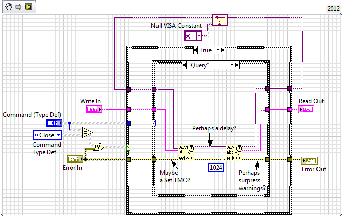

Ben's famous Action Engine Nugget is always a good read. http://forums.ni.com/t5/LabVIEW/Community-Nugget-4-08-2007-Action-Engines/m-p/503801
Now that you went through that let's expand on a specific style of AE that I call a Resource Module.  A RM exposes only those functions that a given application needs to perform using an external resource while protecting "Critical" code sections.  In your example even though the VISA operations block multiple callers from writing simultaineously, you failed to protect the critical "Query" operation so reads got responses to the wrong caller.  The "Query" is critical and needs to block access to other operations until the query is complete.
Take look at this "Very Basic" RM implementation that does protect the critical query operation:
Message 4 of 14

Jeff, I like that! But just one small question - I'm sometimes not very good at acronyms - what's the FBN in your diagram?
Cameron
Feedback Node.Smiley Wink  You could also use a Shift Register and a while loop but, the FBN has some slight advantages that are out of scope for this thread.

Jeff, thank you for your reply. You very eloquently described my problem, and I'm excited to implement the solution you suggested. I am actually working on a different project at the moment, but hopefully I will be able to get to this tomorrow. I have a few follow up questions, but I will wait to ask them until after I've read and fully digested Ben's Action Engine post.
