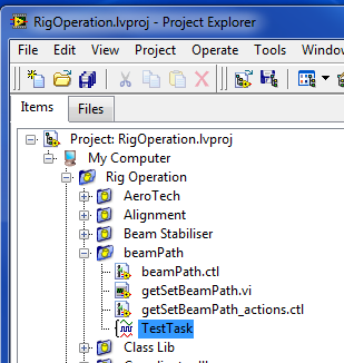

I'd like to create DAQmx tasks inside the folder structure of my project (.lvproj).
If I right-click on folder 'beamPath' and create a New DAQmx task, it results in the above.
However, when I close the project and re-open, it's gone.
If I right-click on 'My Computer' create task, close project and re-open, it's still there:
Where does the task exist? is it a file I can view when looking at the file structure.
I have a very large project divided into sub-systems that I test individually, I'd like the tasks for each sub-system stored within a folder called "tasks" inside the autopopulating folder structure of the Project.

From the looks of it, you have auto populating folders, which if no physical file is saved in that folder, it will disappear when the folder refreshes. I am not quite sure where the DAQ tasks are saved, as I added a task to my project under My Computer as you did, and I do not see it listed in the project.
I think that might be the root of the problem the physical file is stored elsewhere, so an auto populated folder wont work.

The task is specific to the project, I was expecting a file to be created that pointed to the IO.
At present it allows tasks to be created inside any project folder, but unless the task is at the same level as My Computer, it disappears when the project is closed and re-opened.

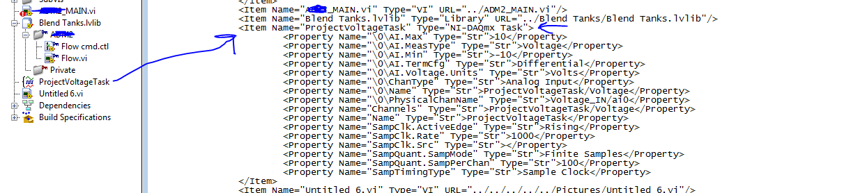

The task and all other DAQmx stuff is stored in the project (*.lvproj) auto-pop folders don't work because there is no file on disk for the task besides that xml file with the .lvproj extension.  Try opening the project with Internet Explorer- you'll see exactly what I mean and learn a lot about how DAQmx tasks live.

Jeff thats interesting, I looked at the lvproj file in notepad, at the XML and didnt see anything regarding DAQmx....maybe I did something wrong?

There is mine
They do hide in the file but they are there. you just need to look for them by "Type"

I discovered what I did wrong, I had two of the same project, 1 was saved for 2013, the other for 2012, I created the DAQ task in only one....oops. I found the DAQ tasks in the lvproj......1000 lashes with wet LabVIEW code.....
