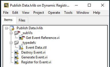

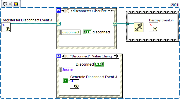

Have a look at
https://www.notatamelion.com/2014/10/23/making-udes-easy/  (with template code in SVN repository)
https://www.notatamelion.com/2016/04/12/implementing-dynamic-user-defined-events/
There you see an example how to put an user defined event (UDE) in a library having 3 public VIs, which form the API for the UDE.
One VI for registering the event at every event structure which is listening to the event.
One VI for generating the event.
One VI for destroying the event.
When using the library the long wires on your block diagram are gone, as in your overview of your named queues.
