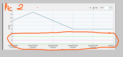

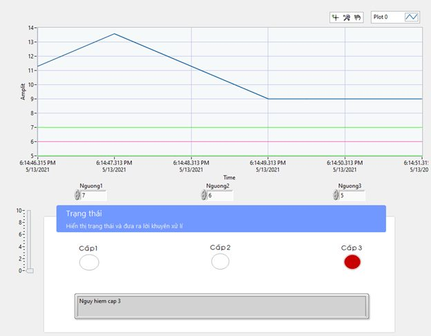

Pic 1: I have a database to display this chart and it is this indicator (Pic 2)

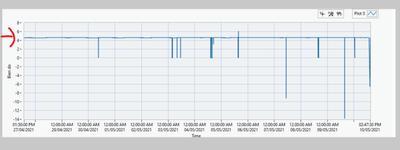

Pic 3: I create this chart but it is not same type.
Problem : So i want to make a chart(Pic 3) but use database, or how to change indicator (Pic3) to indicator(Pic2).

Thanks for answer,
Pic = Picture (Sorry ,my habits)
Those " database" in SQL server create a line in XYGraph(Picture 1) but XYGraph is not have limit as Test Alarm (Graph in Picture 3 have the limit lines (1 pink, 2 green)). So I want to make XYGraph has the limit lines as Test Alarm.

Hi kienle,
as RavensFan explained: you inlined 4 images without any description/labels in your message, but in the text you referenced them by arbitrary names…
That graph in your image shows 4 plots (as far as I can tell from an image).
When you want to replicate that image in your VI then your XYGraph should also contain 4 plots…

Thanks for answer,
I will simplify,
I want a graph ( X: real time; Y: collect value from sensor). Pic 1( mark with cricle is graph)
 but that graph has limit lines( mark with cricle in Pic 2). Limit line has 3 upper limits
Help me with your example. Thank you

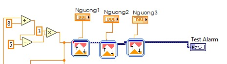

Hi kienle,
as I wrote before: you need to create an array of plots for your graph...

Hi kienle,
it's always a bad idea to rely on ExpressVIs and DDT wires…
Your XYGraph expects plots consisting of [x, y] points, so you need to convert the DDT wire into such a plot:
(When your "database" source gives you evently distributed samples over time then you might go the other way around by creating a waveform instead of an XY plot from your database data.)
