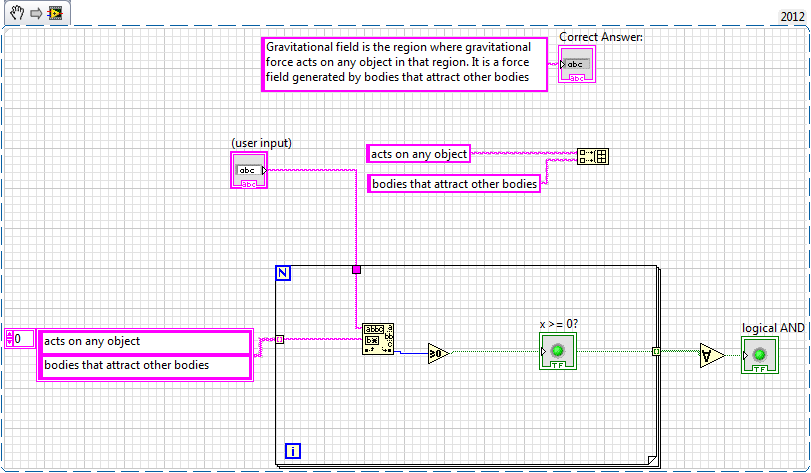

You could use the Match Pattern inside of a FOR loop.  Iterate on your important points (which is an array of strings) and search in the given answer.  The index output of the Match Pattern will be -1 if it was not found.  So do a test of Greater or Equal to 0 on it for a pass.  If all pass (AND Array Elements), then the answer is correct.

Sorry, but how do i (AND an array element)?

To AND array elements, go the the functions palette, inside the Programming > Boolean palette, you will find "AND Array Elements", it looks like a triangle with an upside down 'A' in it.  Simply wire the array to the function and it will AND every element within the array.

Sorry, i really still don't understand the AND array element. Can you please show me some examples or help me edit my program?

AND Array elements is really simple..  Really..
Did you look at some of these tutorials.?

Here's another option (building on Jeff's code).  Turn on the Conditional Terminal on the FOR loop and change it to "Continue if TRUE".  This way, the loop will exit as soon as a failure is found.  Just pass the result straight out of the loop.  If none fail, then the FOR loop will exit on its own (from the auto-indexing) and a pass is passed out.
