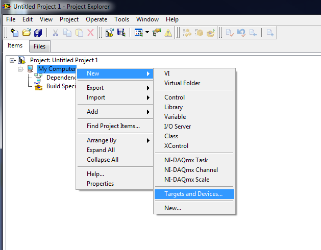

In Project Explorer, when right-click on 'My Computer''-> New -> cannot find Targets and Devices
Is there any settings for finding 'Target and Devices?

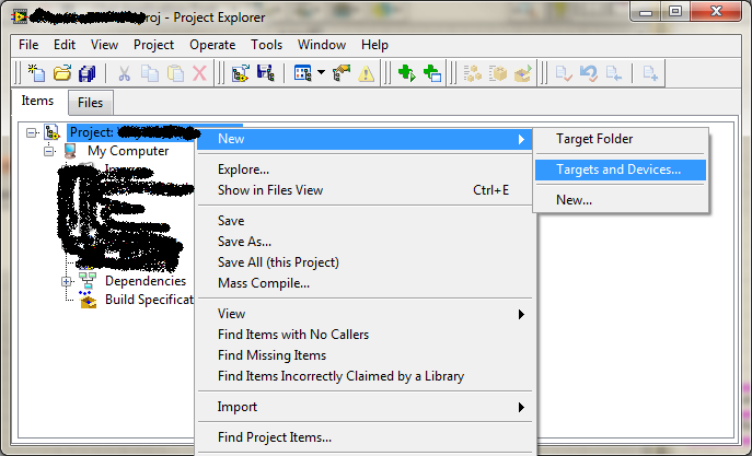

I am using neither of these, but the field point (cFP 1804). As you can see in my second attachment, in LabVIEW 2011 I have ' Add Target and Devices'.

Your just a little off.  Projects have one or more target(s), "My Computer" is one possible target.  but, targets can't have targets.  LabVIEW 2012 improved this small project issue

I do have a screen shot of the MAX that I sent earlier. If I am using only field points, what else would be needed? By the way, if I right-clicked on 'Project:', I do see 'Target and Devices', which tell me it is unlikely to be a installation of drivers/compatibility issue.

Restated: You do not see DAQmx or Targets in LabVIEW 2011sp1 project targets but you do see Targets from project>>new.
What order did you install LabVIEW 2012, LabVIEW 2011 and Device drivers?  Do the NI drivers (and DAQmx) Funtion Palattes appear in 2011?

I see DAQ-mx and Targets and Devices in Labview 2011, but not in 2012. I have been switching back and forth so many times that the statement I made earlier about seeing Target and Devices when is right-click on 'Project' in Labview 2012 is incorrect. The NI drivers (and DAQmx) Funtion Palattes appear in 2011.
The order is:
Labview 2011
Devices drivers
Labview 2012
Devices drivers February 2012
