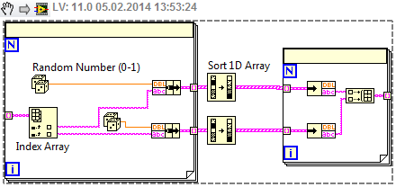

One other approach:
Read file and delete header as GerdW suggested then use the below

Thank you, it seems to work. But one question: how is that function called on which there is "DBL abc"?
(2,931 Views)
UnbundleCluster
