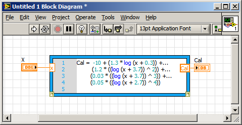

Like this?
19507iFB139DE146531983

Hi andy,
              I did the same as told by you, i am getting a error "semicolon missing " . i am trying out formula node for the first time

The formula node is a different beast. For MathScript you need to use the MathScript node, located in the Mathematics -> Scripts & Formulas. The MathScript node has a blue border. The formula node has a dark gray border.
