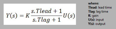

Could anyone help me to understand the mathematical background of PID Lead-Lag VI?
The equation mention in the VI

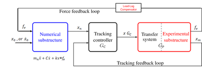

Thank you for your response. I am collecting the encoder signal to the Host PC and the Force in NI cDAQ-9137.
I do not know how to manipulate the timestamp of the encoder waveform or shifting the encoder or force sample array to correct the lag? Could you please give me a reference or example that will help me? The block diagram of my system is here.

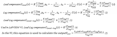

In the PID lead-lag VI Equation (4) is used as a transfer function and Equation (5) is used to calculate the output based on equation (4). Is there anyone please explain it? As per my understanding equation (4) will be like equation (3) for lead-lag compensation. However, they used equation (4) which  I did not understand. How does equation (5) come from Equation (4)?  Thanks in advance.

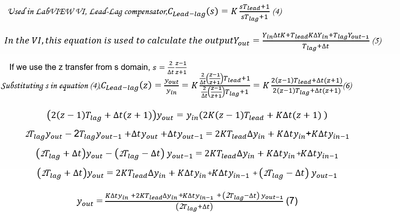

Hi Santo,
Thank you so much for your nice suggestion. Actually, the Lead-Lag VI provided in the LabVIEW does not make sense to me. Maybe I am wrong because I am not a control engineering student. As per my understanding, the equation will be like equation (7) if I just transfer the s domain to the z domain.
Before using the VI I want to make sure everything is correct for the VI. Thank you again.
