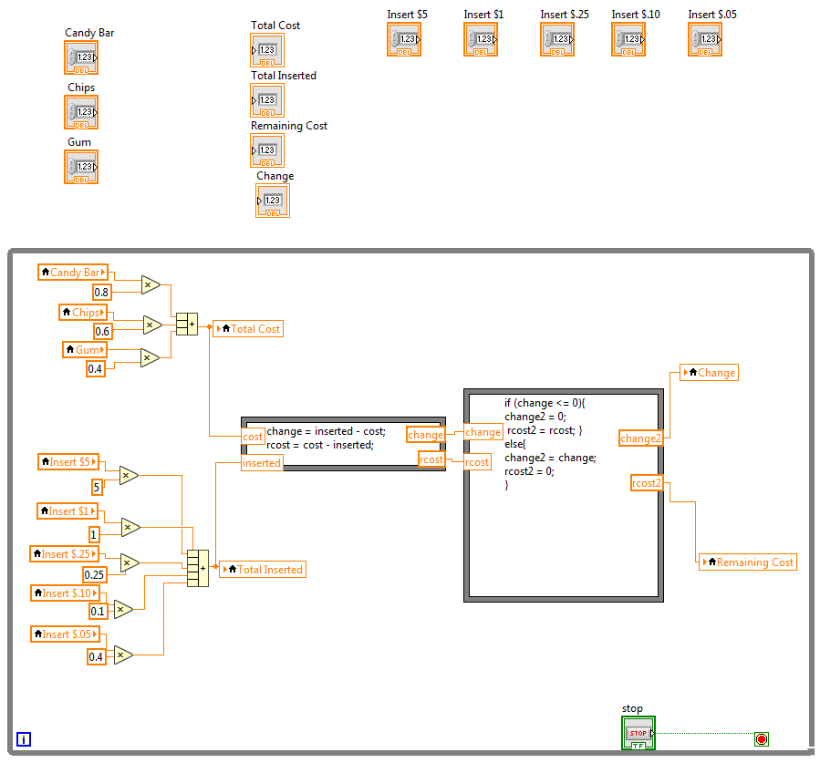

As a comparison, here is a picture of poor mostly formula based code.

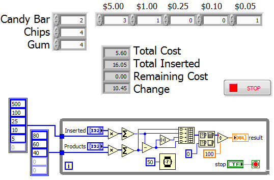

While the graphical code version of the same is arguably much better.
