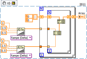

The VI does not produce any errors and I have no broken arrow on my file.  I will re-attach the VI just in case I uploaded an earlier edition.   The issue is mainly that I am trying to produce the following array.
          0.5      0.5
           0.5      1.5
           0.5      2.5
           1.5      0.5
           1.5      1.5
           1.5      2.5
           2.5      0.5
           2.5      1.5
           2.5      2.5
However, when I run the code I get a 2 x 27 (Array Creation Pic)  array not a 2 x 9 (Array Generation Pic).

Hi Cseaman,
If you probe the 'bad' VI, do the wires display the same data going into the Mathscript Node?

Joel,
Thank you for your help. I am not sure why it opens with a broken wire on your system, but operates fine on mine.  I did do the probe like you suggested and was able to identify a math error in my signal processing which fixed the issue that I am having.  Thanks for the help.
