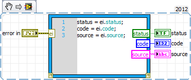

While it isn't possible to directly access the error in/out terminals on a MathScript node, you can connect an error cluster to manually created terminals on the node, then you can access the cluster elements from inside the node:
