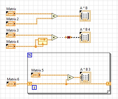

Hi, I'm currently using Labview 2013 and I am trying to place a matrix in a feedback node. It seems like I found a bug, because it does work for a feedback loop.
I wanted to use a feedback node to prevent labview from calculating the same matrix every loop.
Am I doing something wrong here? Or is this an issue with Labview?

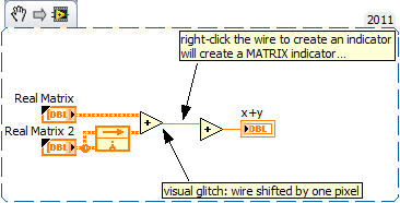

with LV2009 I can create a working snippet:
What's the point of using a shift register or FeedbackNode in your example? When the values don't change you don't need them!
Interesting side effect: the wires are placed different at the ADD node inputs compared to "usual" wires (like scalars or arrays). They are shifted 3 pixels up/down…
(4,472 Views)

More interesting side effects:
Apart from visual glitches LabVIEW will create the wrong indicator when right-clicking the (apparently) scalar result wire of the left ADD node…
Edit:
The result of the snippet for two matrices of 2×2 "zero" elements is "2.16178E-314" when "x+y" indicator is connected to left ADD node. When adding zero with the right ADD node you receive "3.97926E-316". So adding zero (or creating data copies by adding other functions) will change the result…
Looks like a compiler error to me…
