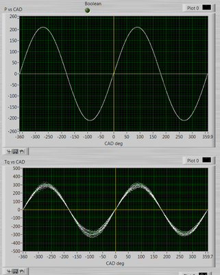

thanks for waiting so long. So finally the 9215 has solved the issue. I following pictures show that.
Screen Shot 2012-12-18 at 12.25.13.pngThe hardware was as usual. I didnt have all the engine and test bench so i just input sine wave as the pressure signals and the same for torque signals (hence the two graphs). The timing clocks were also generated by another function generator(external) . the pressure graph (top) was aquired by NI 9215, and the torque graph (bottom), was aquired by 9205 at 8 microsecond conversion time. both were sampled at 90 K samples/second. As you can see the difference is stark, there is excessive cross talk in the 9205. This crosstalk diminishes if i dont sample more than 1 channel. i tried that and it behaved almost like 9215. Also note that the amplitude of 9205 is wrong since this is an averaged output, over 50 cycles and each time a cycle is averaged, the points dont add up correctly, ultimately increasing the error.
So conclusion, if you want good signal at high sampling rates, dont use a multiplexing card, and if you do, please common all the inputs to ground to reduce impedances and maybe you will have better signal (didnt work for me)..
I am attaching my code so that if someone wants to not repeate the mistakes i did, which is however the real learning 🙂
Thanks for the help!!

Hello subir,
It's indeed always a good idea to be very thoughtful about grounding considerations with multiplexed (and actually also with non-multiplexed) cards.
In general you will however see less "grounding problems" with simultaneous sampling, because you're not sharing the ADC.
