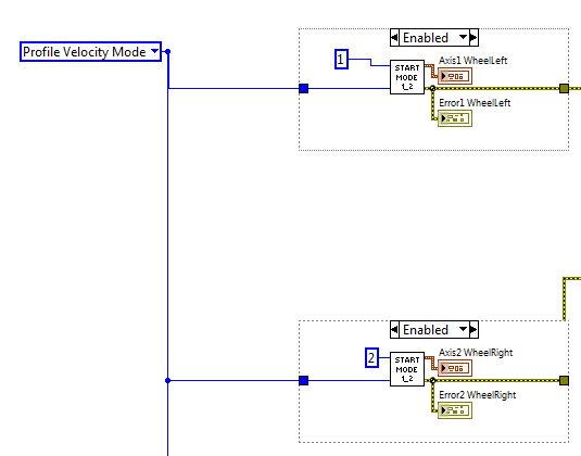

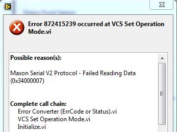

I execute my program trying to communicate with two EPOS2 24/5, the nodeId = 1 communication is normal and it is working normally, but with the nodeId = 2 I receive this error is attached bellow.
I tried with the Example_demo.vi but it is not working with ID = 2.

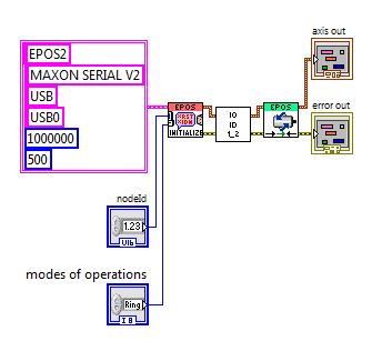

The program to initialize the motors is inside a function using labview of 32bit wiht EPOS2 dll of 32bits as well. if I execute the EPOS studio previously, and execute my program after the error does not appear.
I tried to find the error everywhere in internet and I could not find it. Someone could help me? how I can to resolve?

Hi David.  We just finished up a small project controlling 4 Maxon motors using EPOS2 controllers.  We ran into the same error you are describing (and many more!).  Eventually we worked out the attached code to initialize the controllers and control the motors.  Start with motor_ae Folder\Users\mrw\Documents\projects\machine_demo\maxon\motor_ae.vi.  That is the .vi we use to control the motors.  Within there, open_axis.vi -> init_ctrlr.vi to see how we initialized the controller.  This project was a favor for a friend, so I can share code 🙂
Are you able to move both motors with the EPOS studio?  That will at least confirm that your CAN is wired properly.

In EPOS Studio, open Tools -> Object Dictionary. Make sure the Active Object Filter is set to All Object and check what is the Node Id Value (index 0x200) of the EPOS controller that generate the error. If it's not set to 2, right-click it, select write value, set it to 2, press ok and save the project.

Thanks a lot!! really useful! I adapted to my code and it is working perfectly! Smiley Happy Smiley Happy
