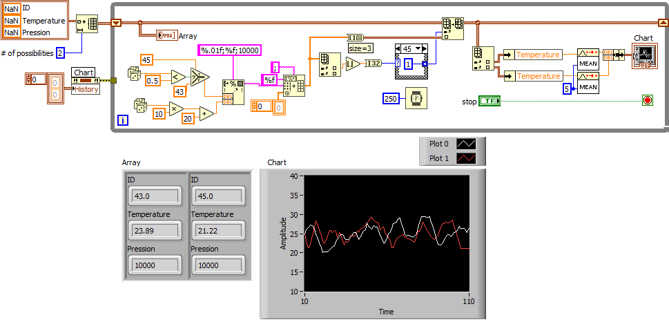

Replace your convoluted case structure with the following:

Here's what I would do (all ideas from my first post, now some repeated by others). Fully scalable for as many channels as you want after a few more simple changes.
Also remember to chose a plot style with actual points, not just lines. with only lines you will no see point surrounded by NaN on each side! Another option would be to graph stale values in the case of missing values. Maybe even better.
(Also note that you code still has potential race conditions because you cannot guarantee that the chart history gets reset before the loop starts. Right?)

And her's the same with random temperatures.

As I already hinted, I would recommend to retain the stale (=last seen on that detector) values instead of using NaN. Now the 5 point average looks nice and there are no gaps.

@siwalex wrote:
the hub can recieve only 1 information for exemple node 43 in one time. if he recieve node 43 on time then 10 times in a raw node 45, the mean will be wrong.
is it possible the mean not take in consideration the NaN? or just take the last value who was not a NaN for the calculs?
My latest code does not use any NaN except at the beginning before any values have been received. After that, each channel shows the mean of the last five iterations. If there are more than five iterations with no new data, the displayed value will be constant of course. I don't consider that wrong by any definition and I am not sure why you are bringing up that ugly word.
