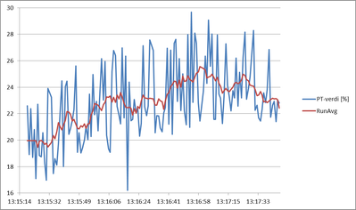

Hi King,
this is what you get from your unfiltered data with a simple running average in Excel:
There is noise, and there are ups and downs…

how did you make this average line?

Hi King,
I used Excel. Excel has a huge list of functions and you can create averages quite easily…
