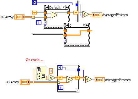

To average the l pages of a 3D array, autoindex on a For loop and add the pages using a shift register initialized to the correct size. At the end, divide the 2D array coming out of the shift register by N. No explicit indexing needed.

I don't understand the multilpying. Are you trying a geometric average? Summing seems more appropriate.
In any case, these alternatives below do the same thing with one loop (One could use "initialize array" in the bottom code, requiring taking the correct sizes). Many other variations are possible:
Note that these are probably more efficient because frames are adjacent in memory while the elements of a Z columns are spread apart.
