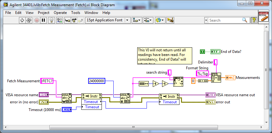

However, if you dig into the driver you will find the core reason:
the input string is not checked, so if you read (for what ever reasons) something that the spreadsheet string to array coudn't convert correctly, it will turn out as a zero value.
**bleep** happens, so you have to implement a string check (use the error out from scan from string)
