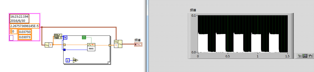

You should not have the Initialize input wire up.  You are essentially doing nothing to the data right now.  When you do the moving RMS properly, it will be an obvious square wave (not filled in with you sinusoid).
