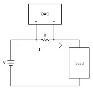

Hi GerD,
Thanks for the reply. I also find it strange if i put the resistor in parallel to measure the current. But I follows the DAQ Assistant 'curent connection diagram' which shows the shunt resistor is connected in parallel with the voltage source. So I'm abit confuse this part. Anyone can clarify this?
Thank you very much.
Message 5 of 16
(9,670 Views)
Hi Kiat,
when I use the DAQ assistent I don't see any resistor in parallel with a source:
Source and resistor are in series as I have suggested…
Message 6 of 16
(9,667 Views)
The shunt resistor is normally a very low value which is put in series with the load. You then measure the voltage dropped across the shunt and use Ohm's law to calcukate the current.
So if you use a 1 ohm resistor as your shunt, (DON'T PUT THIS DIRECTLY ACROSS YOUR BATTERY!!!!) 1V drop across it represents a current of 1A., 200mV represents 200mA etc.
Maybe you should be using your rheostat as the load, which would make sense since this can be varied to give different current readings.

Hi GerD,
It is in Series. I see wrongly at first.
Thank you for ur help.
