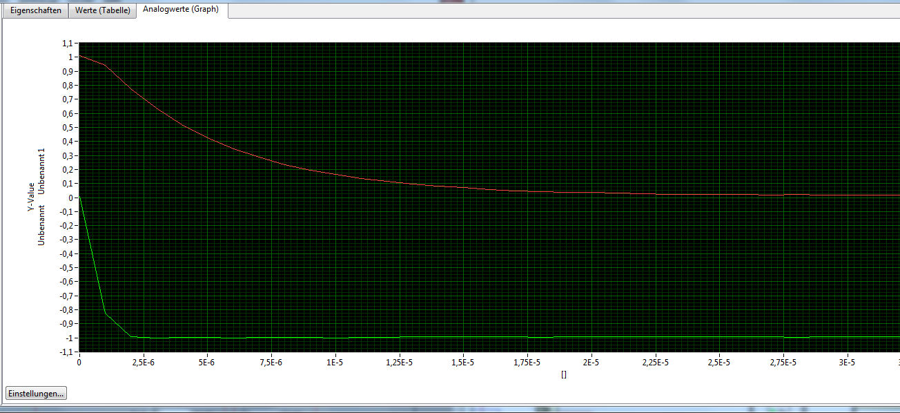

I'm generating and acquiring signals at the same time using 1 VI. And I need to display the delay-time in front panel. As you can see in the picture below, I have like 2us delay (for green) and about 25us (for red).
I'm using PXI 6733 to generate analog signal, and using PXI 5105 to acquire.
Is there any way to display this delay in frontpanel??
Yan.

to display the delays you could use numeric indicators. When you want to display it in the graph I would suggest cursors...

it seems you don't want to display those values, but you need to calculate the values. That's a big difference!
You need to determine when the signal has settled. When you know to time of signal settlement you know the delay 🙂

there are probably simple solutions like using fitting functions or checking a running average for signal settlement...
