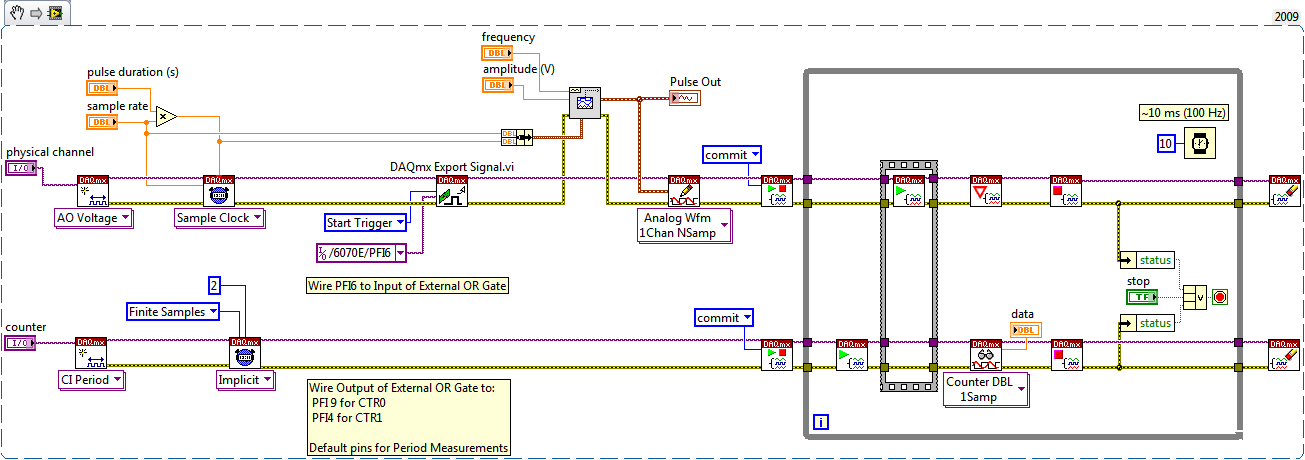

You picked a tricky application to get started with.  It's a bit hard to explain in words so here's a VI Snippet showing how you could configure your program if you want to use the counters:
I think this should work for one channel.  Adding another channel would involve creating another parallel thread for the 2nd counter task.

1.  The CI should be connected to the output of the OR gate (Start Trigger + Comparator Output).
-AO will be re-start every time you need to generate a pulse. This gives a single pulse of AO Start Trigger at the very beginning of each pulse output.
-The result of the comparitor will oscillate with your signal and will give multiple edges once the signal is received.
We start the counter right before the AO task so it is armed and ready when the start trigger comes (the first edge the counter sees).
2.  The Implicit Timing function above ensures that we read back the first sample.  When configuring Implicit Timing, we actually latch a sample into a buffer on each edge of the input signal.  The very first sample read back from the buffer will be the first period of the waveform.  We can ignore the 2nd sample (2 samples is the minimum amount allowed for Finite tasks).  When the counter task is restarted this gives us a fresh buffer for the start of the next acquisition.
3.  I would use the code posted above.  I was able to keep the SW loop running on my 6070E at ~100 Hz (it was the closest I had immediately available that is similar to your 16E-4).

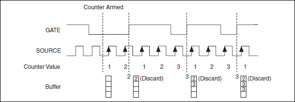

My mistake... the program requires a slight change.  You need to modify the portion that performs the read.  Change the read to a multi-sample instance, and index out the 2nd element of the array rather than the first:
The problem can be explained from the following diagram showing how the buffered period measurement works:
The E Series board (and most M Series boards) do not automatically discard the first sample.  This sample represents the time between when the counter is armed to when the first pulse is received.  The ~4ms you are seeing is likely the time it takes to start the AO task.  I guess I've gotten used to working with our newer X Series boards which discard this extra sample in the hardware.
You'll still have some added latency from the transmitter/receiver and comparitor, but hopefully that should be relatively constant and can be calibrated out.  You're absolutely correct about the receiver as a start trigger generating too many pulses--the DAQ hardware would require a single pulse.
