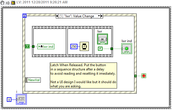

One more thing. I think if you modify the event case for latch when released as follows it should do exactly what you want.

Message 9 of 9
