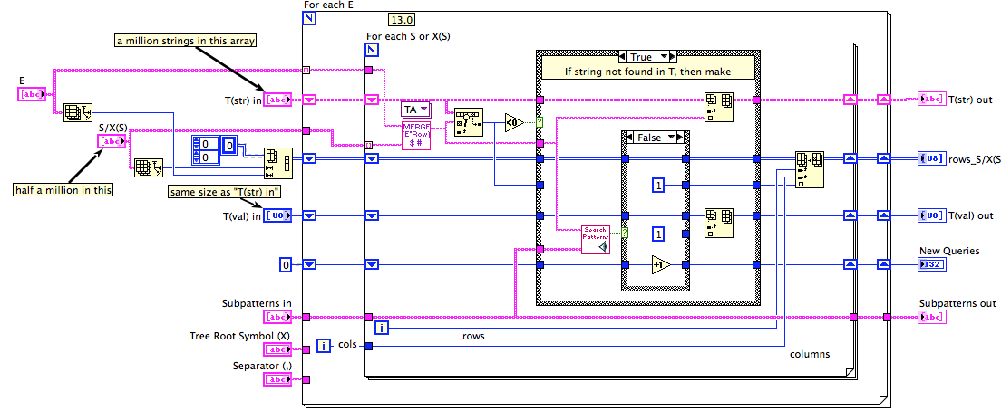

1) Speed issue: I will explain this with an example. During the runtime, there is a 1D String array (let's call it "X_str") of around 550,000 elements which looks up each of those elements in another 1D String array (let's call it "T_str") of >3 Million elements, and when a string is found in T_str, the match index is looked up in another array 1D U8 array (let's call it "T_val"), and the corresponding value (either 0 or 1) is stored in the position of X_str into another 2D U8 array called X_val. So for example if a string "aaaa" is in X_str[450], it's looked up in T_str[] and is found at T_str[135000], then the value at T_val[135000] is fetched and is stored in X_val[450,column id] (either in column 1 or 2 ... as per the cycle).
Now, I am doing this in the simple manner, without using the "subroutine" priority. What could be an effective way to do this? So that the speed is fast. The program in "Update Arrays.zip" shows my implementation of this part.

@Vaibhav wrote:
I am trying to redesign the algorithm so that many unnecessary steps are avoided, but I also want to know what can be improved in terms of my LabVIEW usage.
Just looking at your "update table", the main speed bump is probably the repeated searching through a string array with a million elements. Since the search is linear in array size, this takes long because your array is not sorted. You might try to store the strings as variant attributes instead, giving you a "log N" lookup performance instead. I believe that would dramatically speed things up.
Your VI has an incredible amount of dead code and duplicate code. For example the innermost case differs only in a increment and a diagram constant that is either 0 or 1, so why duplicate all that other code? Many things are in shift registers that never change, so use a plain input tunnel instead. Below is a crude attempt at simplification, it won't be much faster, probably. I have not implemented the variant attribute solution, because it would also require changes in the caller, etc.
 For more details on using variant attributes, start with this thread. Let me know if you have any questions. Variant attributes are stored in a red-black tree and lookup is thus as fast as a binary search. It will be many orders of magnitude faster than your linear search.

Here is a quick attempt at a variant version. The order ouf the output is different, but that might not matter. The entries are still correctly matched to the values. If it matters, a few things need to change.
Of course you would carry the data inside the variant across caller and subVIs, etc. There is not need to extract the actual data until you save.
I don't know how it performs memory-wise. 😉
The three LEDs show that the outputs match the expected values for the default inputs.
I changed the order of autoindexing to simplify the generation of the rows_S/X output. Modify as needed.
