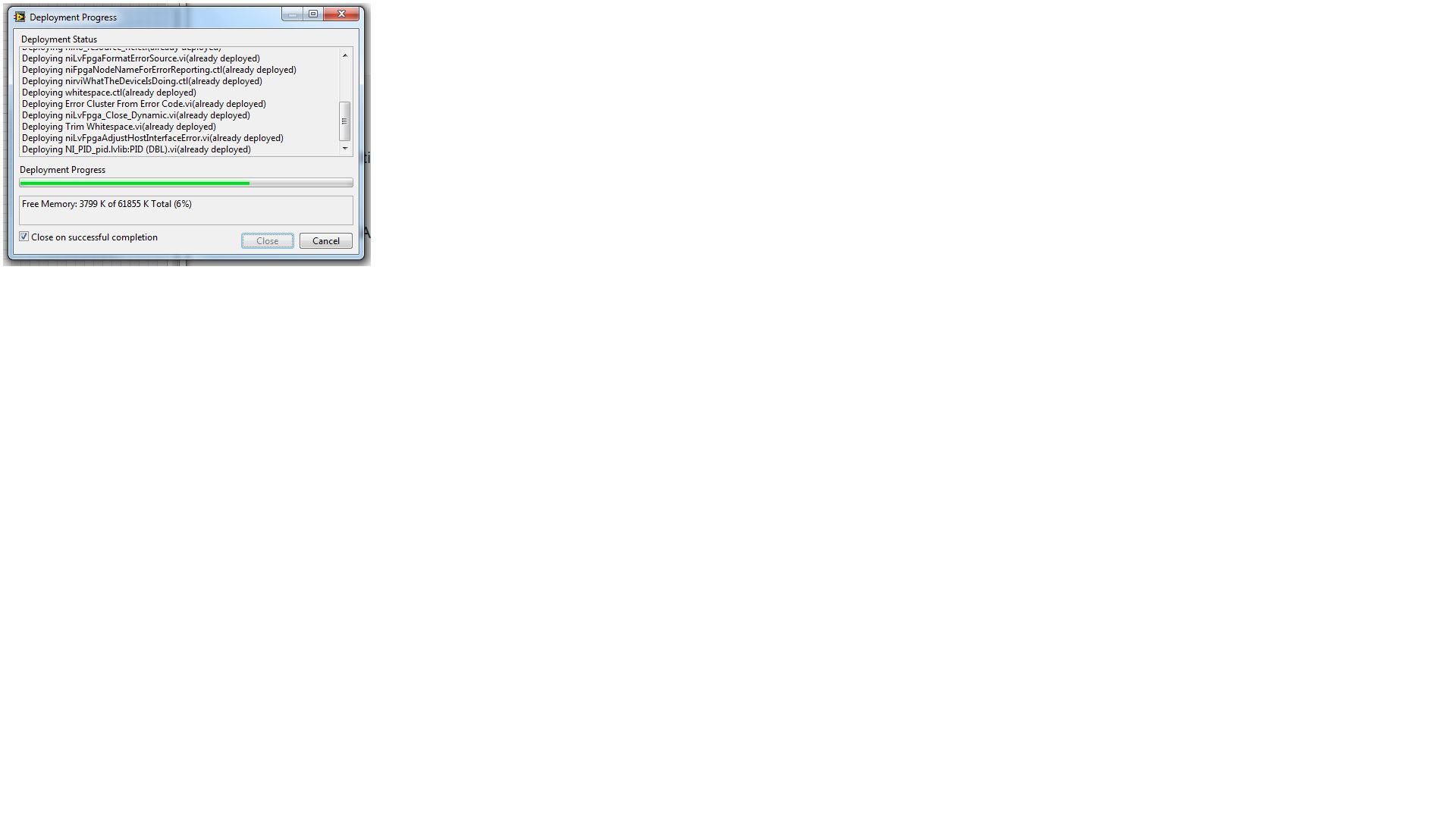

Thanks very much for your reply! Well, that happens when I run the program in the Rio. In the project the program is under the RIO.
I've attached a screenshot below.
