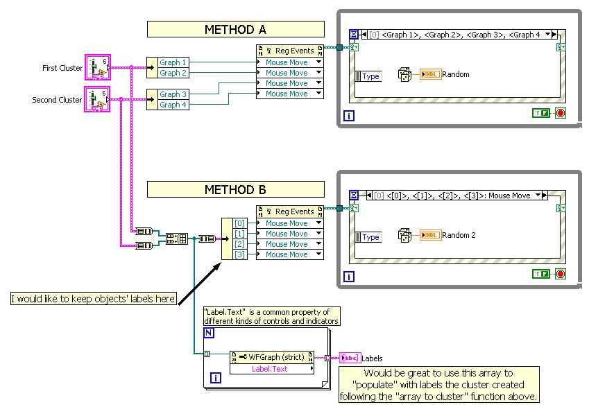

I have a code with several SubVIs, each one with multiple objects. I would like to group all objects' references in one single source in order to have access to objects' properties by means of property nodes in other VIs. Since I have one Reference Cluster (which is populated with real references as SubVI run) for each SubVI, I would like to merge all these reference clusters into one. Nevertheless, when I do that I lose all labels of the objects. Is there a way to merge multiple reference clusters into one and keep objects labels?

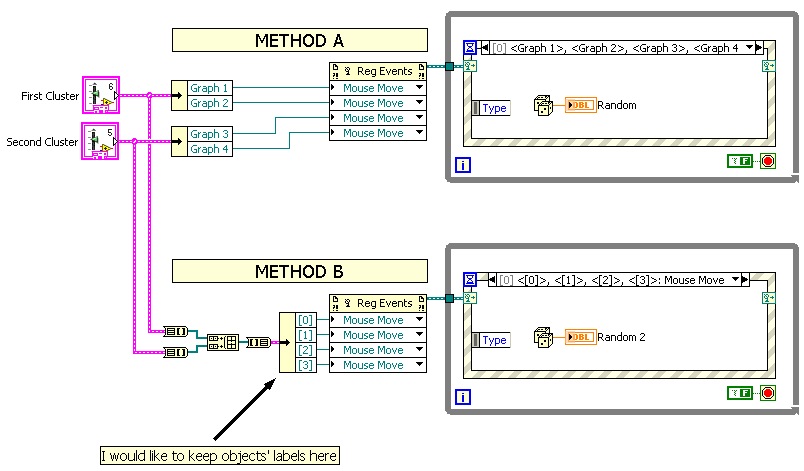

See attached picture for information. I just used an example how dynamic events can be used to trigger events across VIs (dynamic events are crucial for my code). Method A shows the regular way to get the references from two different reference clusters. As you can see the labels are kept.
On method B I try to make things easier, and instead of having multiples "unbundle by name", I just convert the clusters to arrays, use a build array function to concatenate all references into one single array, and them convert the array back to a cluster. Nevertheless, by doing that labels are not kept.
Thanks.

I can't do that because I don't have all objects in one single VI. I have multiple SubVIs, each one with a set of objects. I created a reference cluster for each one of the SubVIs and they are all "strict typedef". I just want to merge all these references clusters into one, but keep the labels in order to use unbundle by name function to have access to the references.
FInd below a updated picture. I am considering getting all the labels from the references (since it is a common property for indicators and controls, and because of that I can use a property node inside a for loop) and use this array of labels to feed the cluster with all references. But I don't know how to achieve that.

Let I tell you the whole story. I used to have one single front panel with all the objects. Following your advice I created a GUI refs (strict typedef) and use it to access my references into several SubVIs, by means of unbundle by name function. Everything was working great, but I decided to split my big front panel into small parts (VIs) and because of that the objects are not all at the same place as before. Then, I created several GUI refs (strict typedef), one for each set ob objects of each VI and now I just need to merge all these GUI refs into one, keeping the label names.
Keeping the labels is crucial for me because I have several SubVIs with unbundle by name functions getting the references from the old GUI ref. Since I didn't change the labels of the objects (I just spreaded them over multiple Vis instead of leaving everything into one single front panel), I will be able to use my unbundle by names functions as they are right now. I need to find a way to merge several GUI refs (strict typedef) into one, keeping the labels of the objects.
Please, provide me with a simple example showing how to merge two (for example) GUI refs clusters (strict typedefs) into one. It is not necessary to be done on "runtime" since I can just run the code to merge the GUI refs, and them convert the indicator with all refs to a control and use it as a Reference Cluster (strict typedef).
Thanks a lot.
Dan07.

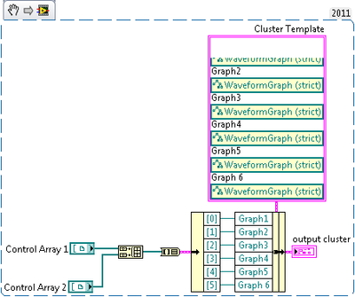

Dont know if its  a lame answer.
There are limitations:
1.The number of controls  cannot be varied in runtime.( as size is required in array to cluster function)
2.Labels has to be manually typed in the reference cluster.
Nice interpretation of my suggestion Frabto!
